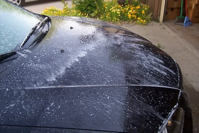

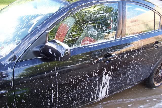

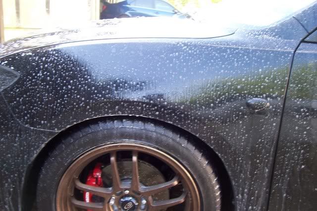

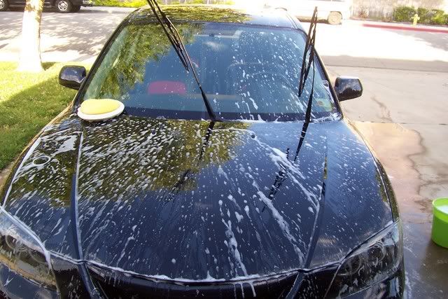

    I decided to try two different soap with the foam gun,
    Here are the foaming/sudsing action of Megs NXT:
    As you can see, it produces fair amount of Suds/foam.
    I let the suds sits on the car for 3-4 mins to let the soap do it's thing and then rinse off.
    By this time, the car was already clean :D i didn't see anymore dirt on the car.

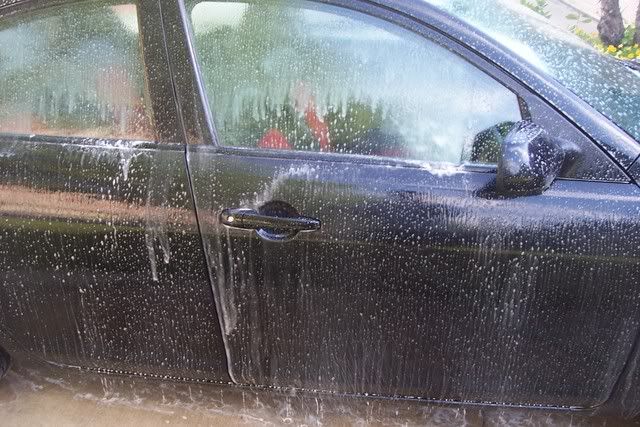

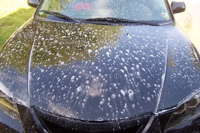

    Here are the foaming/sudsing actioin Meguiars Gold Class on the foam gun:
    As you can see, it kinda produces more suds than the NXT,
    and the megs gold class smells so good!!!
    i let the soap sits for another 3-4 min then rinse off,
    here's what you get after:
    yes, the car is already clean without me even touching it!!

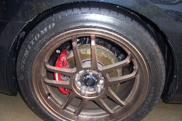

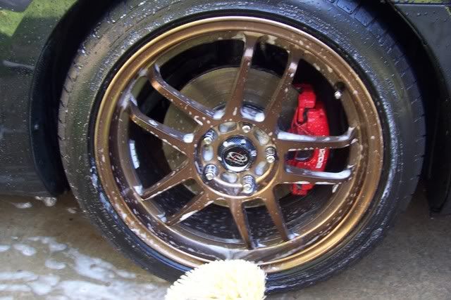

    Here's what i use for the Wheels:
    Simple Green in the foam gun
    Rinse the wheels first
    Then spray it on:
    Don't forget to spray the Wheel Well also
    Next step is to agitate the dirt with a brush:
    the brush i'm using is Meguiars
    Rinse:

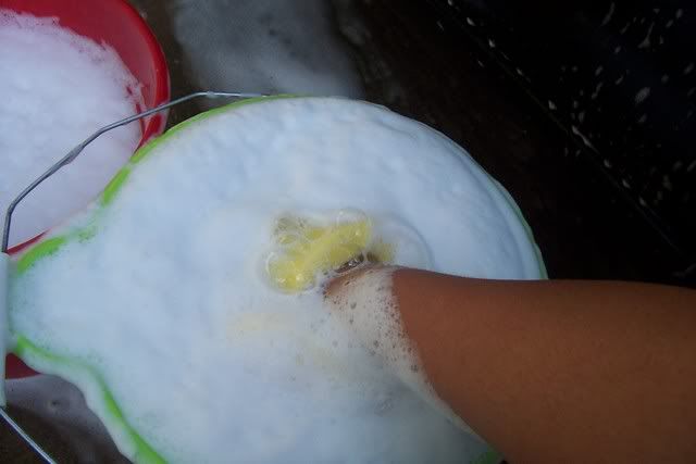

    OK now we get to the washing part:
    Fill Two buckets with water,
    in one bucket, add soap, i use the gold class in this one. (RED BUCKET)
    the other one is just plain ol water. (GREEN BUCKET)

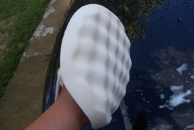

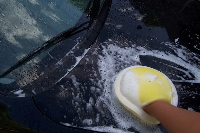

    here's the Shmitt:
    and here's the Shmitt in action:
    After each panel, rinse the mitt in the green bucket, after that, dip it the the bucket with the soapy solution, and proceed to wash another panel
    Remember to wash from top panel to bottom.

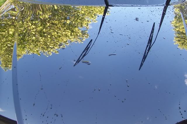

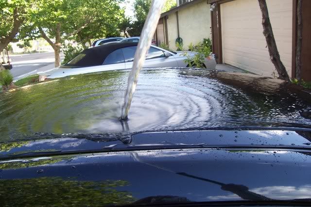

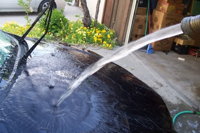

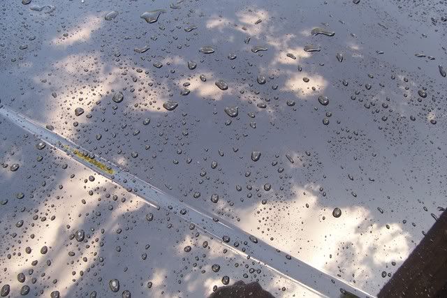

    Rinse:

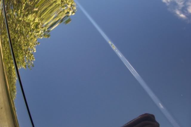

    Then rinse with NO nozzle, this is called Flooding the Paint, drying will be so much easier with this.
    Compare this image to the one before the flooding, now you see why it is easier to dry off the car with flooding?

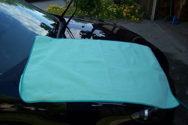

    Next step is to dry the car with the Cobra Guzzler:
    See the Size of that thing??????
    i didn't wring the towel at all during the drying of the car.

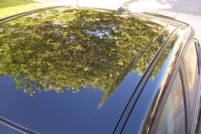

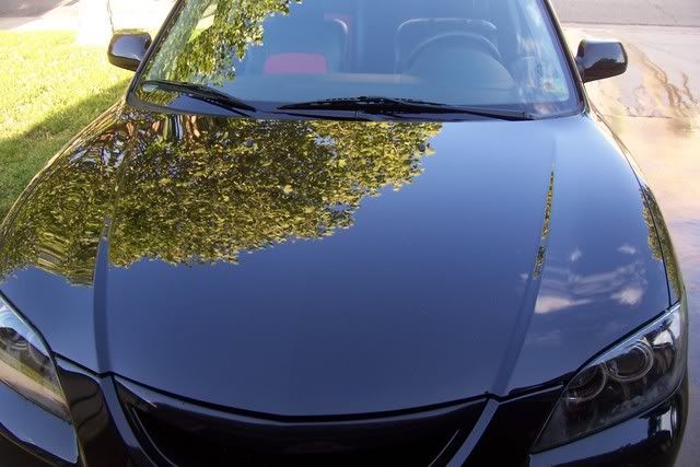

    All nice and dry now:

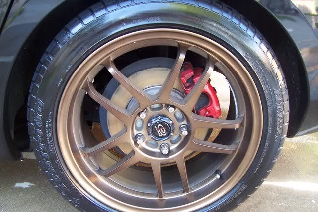

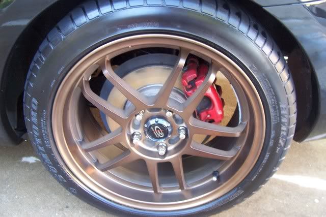

    Drying the wheels and tires is the next step, i just use OLD microfiber towels for this:

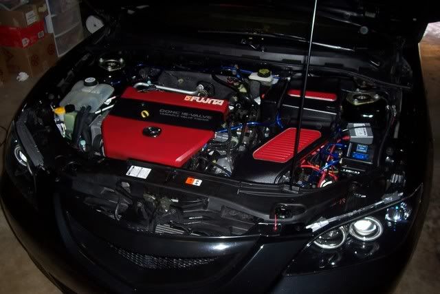

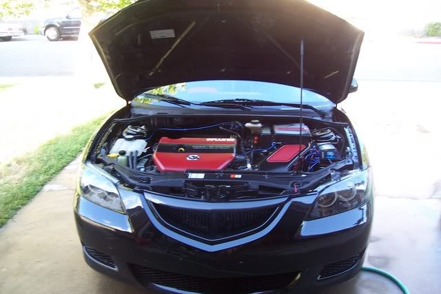

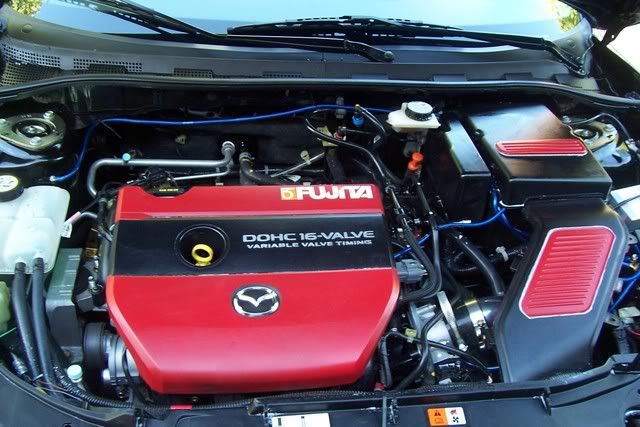

    Then i dry the engine bay, which i washed it earlier but i didn't take any picture:
    then i used the armor all TIRE FOAM on the engine bay (plastic part only)

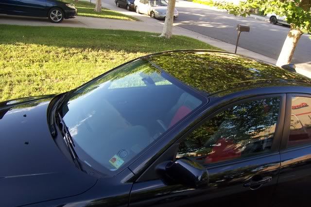

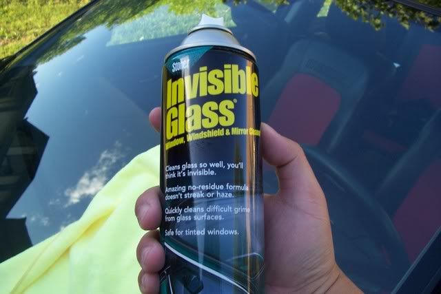

    Next step is cleaning the windows:
    Streak Free Finish!

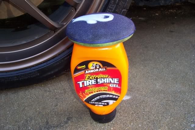

    Next, i applied some tire dressing:
    BEFORE:
    AFTER:

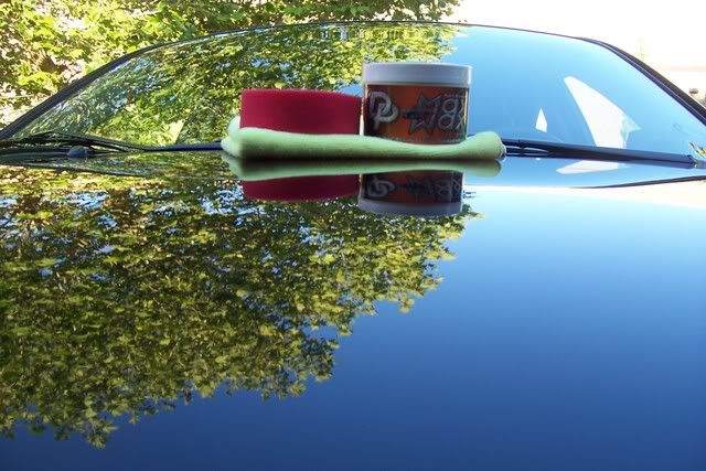

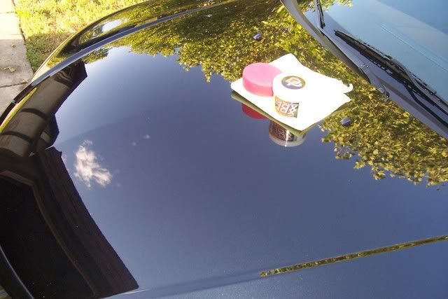

    i decided to break out the DP max Wax and applied it to the hood only:

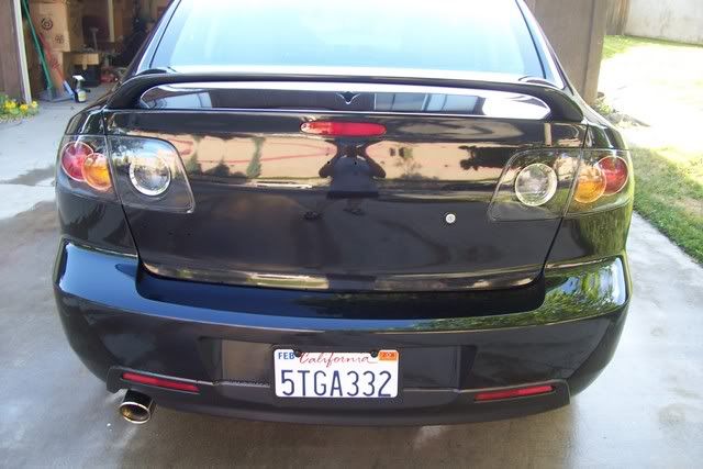

    FINAL STEP:
    Put her in the garage, yes, that is Duct tape on my headlight, i just didn't want to risk any fogging inside it when i washed my engine bay.
